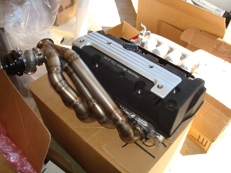

Popis úprav z amerického fora...
k24a4 block
blueprint sleeves
9:1 cp pistons
blueprint turbo rods
oem bearing
crank balanced and polished by blueprint
assembled by blueprint
type s oil pump
type s oil pan
k20z1 head
all supertech valvetrain
rbc cams
excessive manifold with 75 mm mustang tb
ep3 trans
quaife lsd
turbo stuff
synaspe turbo manifold with vband
Garrett gt35r with tial housing
tial 44mm wastegate
tial 50mm bov
k24a4 block
blueprint sleeves
9:1 cp pistons
oem bearing
type s oil pump
type s oil pan
k20z1 head
rbc cams
ep3 trans
quaife lsd
turbo stuff
tial 44mm wastegate
tial 50mm bov
