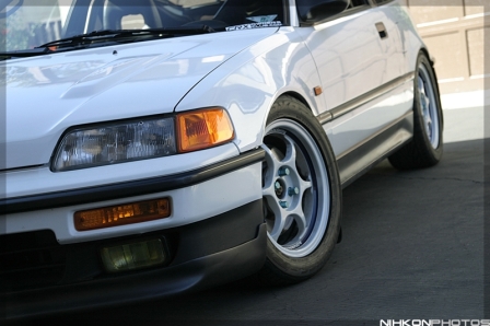

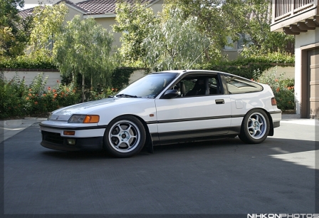

Me by se to proste libilo tak nejak takhle a nevim jak na to :-(
