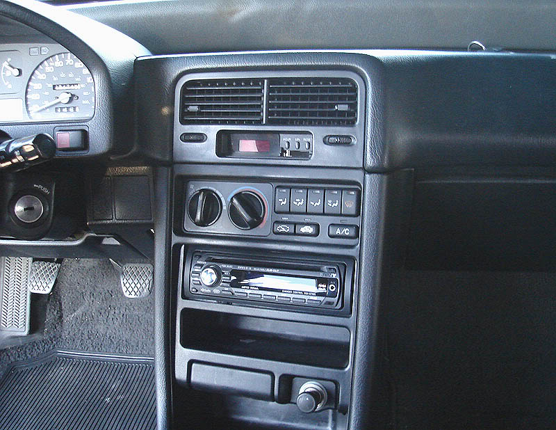

Here is my old clunky stock control:

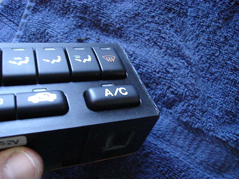

I bought this '92 Accord unit from a guy on CL for $50

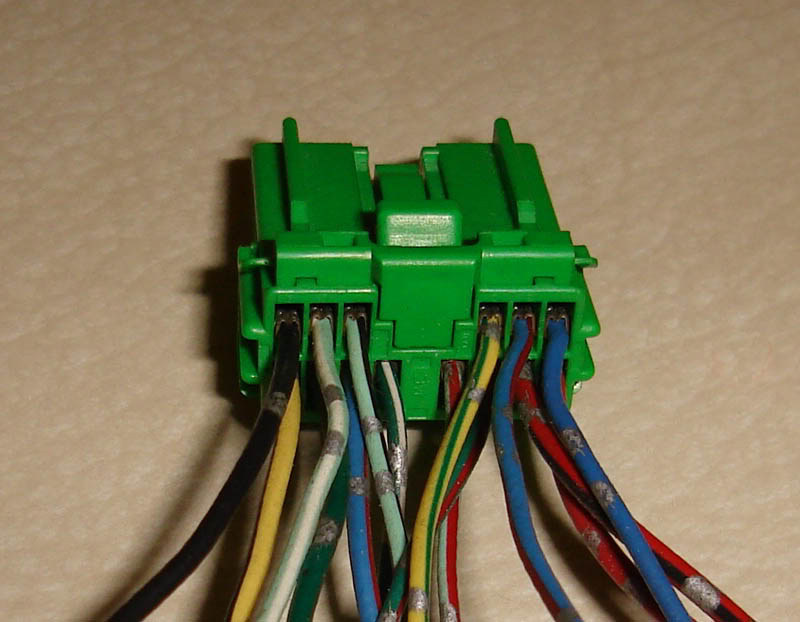

Here is the Accord "green" plug for visual reference:

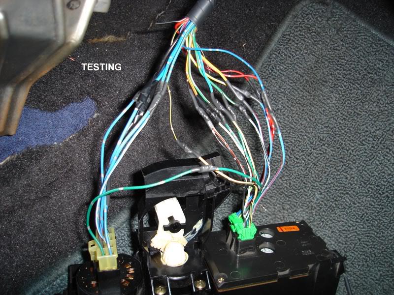

I first wired up everything, and tested to make sure it worked, and then soldered/shrink wrapped the connections.
If you ever plan on re-installing your old CRX control, you may want to use connectors instead of hard wiring:
Wiring the fan switch. Most all of the wires are the same color, the blue/red wire on the accord plug (5th speed) is not used:
During testing I found that my light circuit for the control knobs did not work. I had to clip the wires off the bulb and hard wire them to the CRX harness. The light wires are the red and red/blk wires. You will almost certainly be able to just connect the red, red/blk wires as shown here:
There is some confusion as to wiring the grn/red and grn/wht recirculation/fresh air connections. The grn/red and grn/wht MATCH between the Accord and CRX. Therefore:
Accord grn/red is attached to the grn/red CRX wire.
Accord grn/wht is attached to the grn/wht CRX wire.
I tried both and visually verified that the operation was correct.
One thing of note is that there are TWO grn/wht wires coming out of the CRX harness. One goes to the recirculation switch and the other to the floor/vent control. If you get them criss-crossed like I did, no big whoop, the world does not end. The recirculation vent just goes into a never ending continuous open and close cycle until you press the fresh air button. If this happens, just switch the grn/wht wires as seen in the diagram at the bottom of this page.

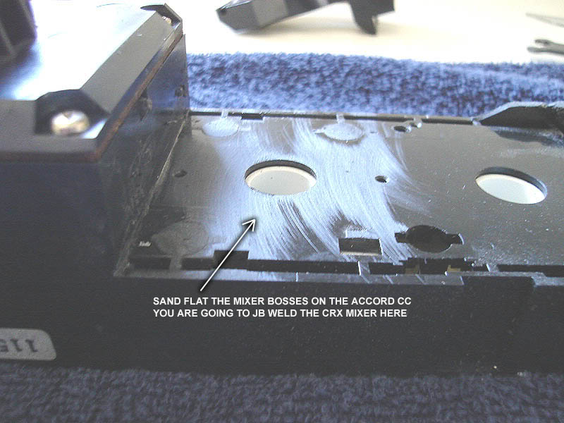

Take your WMD's and remove the bosses that the Accord mixer screws into. My light circuit was FUBAR so I clipped the light bulb wires as seen here. YOU MAY NOT HAVE TO:
Use your drill/sanding disk to sand the bosses flat:
In order for the Accord knob to fit, you'll have to sand a flat on the CRX mixer shaft. Be advised that even after doing this, one of the tongs on the shaft broke and I ended up JB Welding the Accord knob on:
