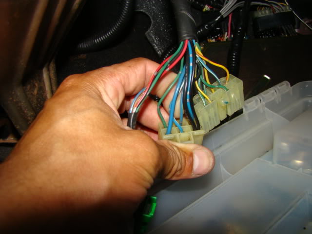

1. Find your unit with the complete harness or at least the green plugs.
2. Identify your cables (I have them in a getto diagram so it will be
easy for you'all)
3. and get ready to have fun.

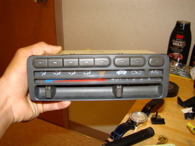

This is the unit I got and the wires from the rex.

6. your new unit
7. your broken, not working or whatever the case might be old unit.

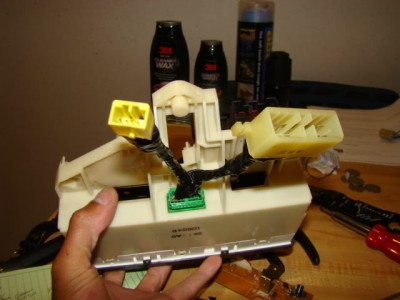

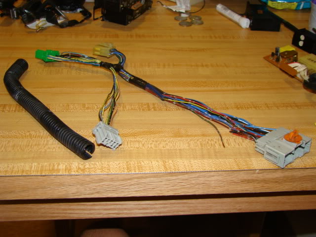

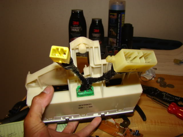

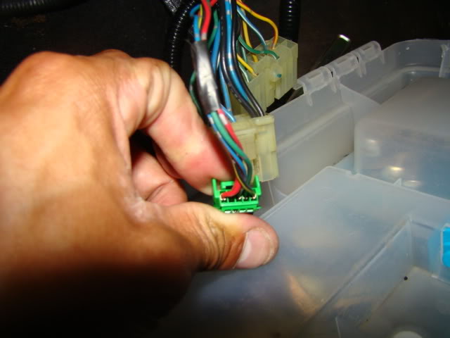

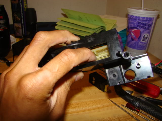

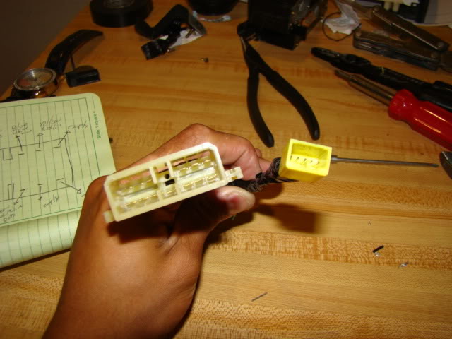

Here we go.... First, cut the green plug off the EG harness, making sure
you have enough cable to cut and move. I dentify each cable by color.

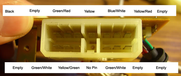

There is a cable that doesnt match the EG harness: a green/yellow stripes
and grey dots. That one goes with the green/white stripe cable from your
CRX harness. The rest are exactly the same.
Here is the EG harness stripped.

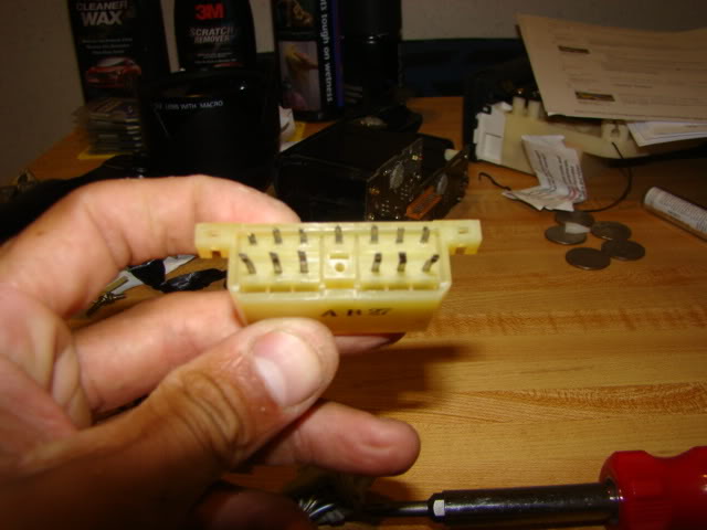

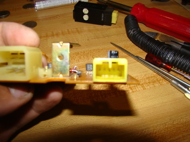

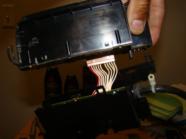

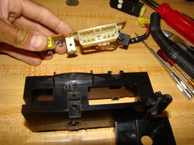

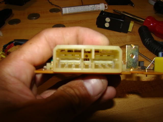

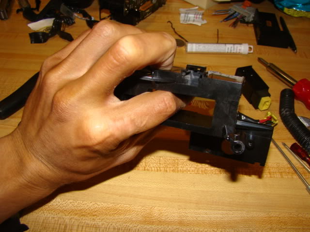

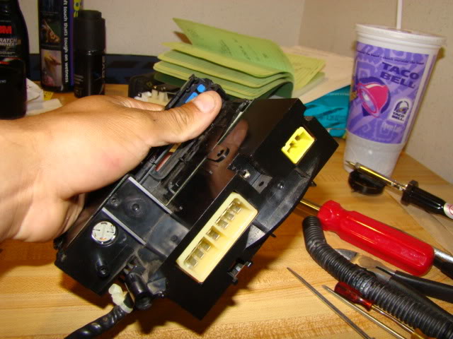

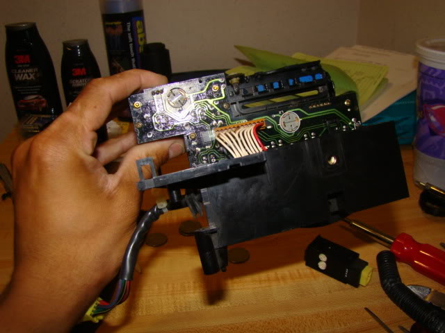

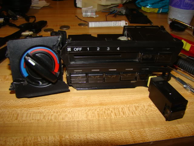

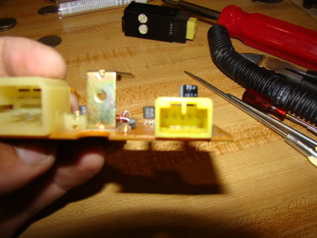

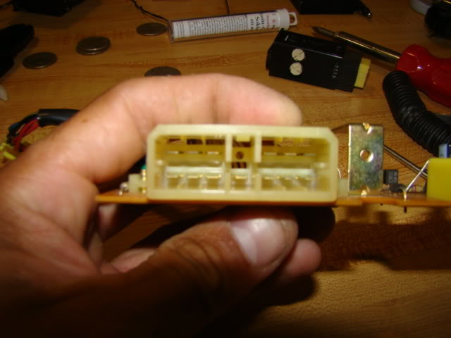

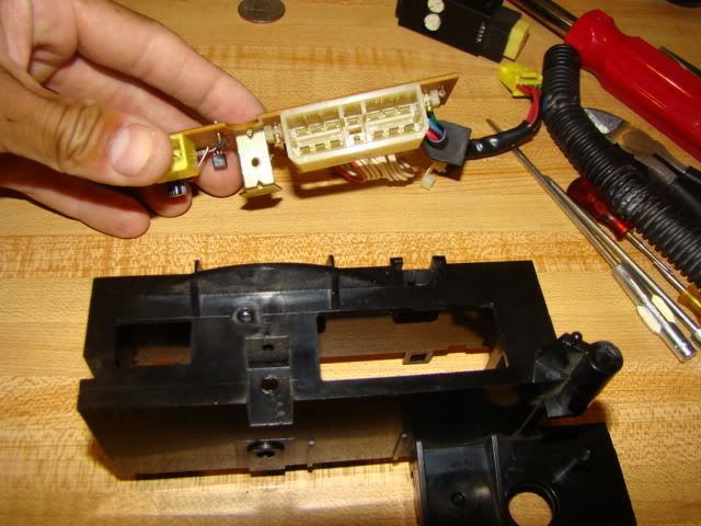

Next, disasemble the back part of your old unit so you can detatch the ports of that control. Either brake them, cut them or unsolder it. I broke it, since my climate control wasnt working anymore.

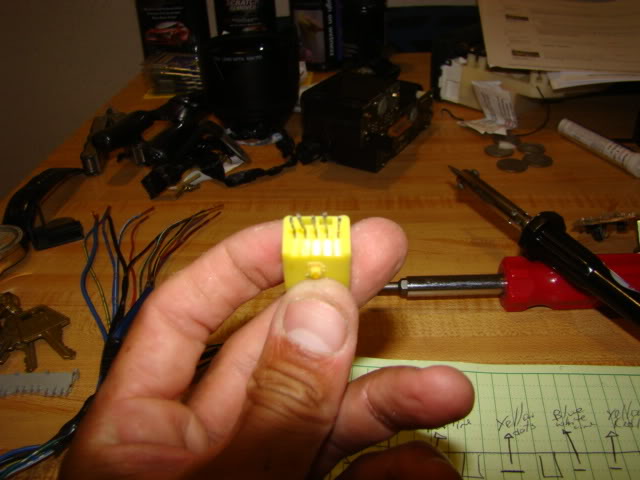

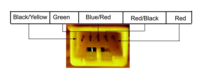

This are the plugs you will need to do the new harness

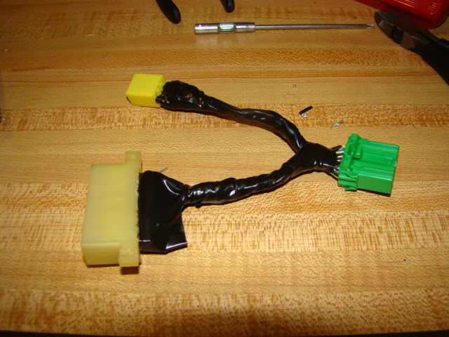

Since you have already identify your cables, its time to start the soldering process. If you decide to use plugs by all means do it.

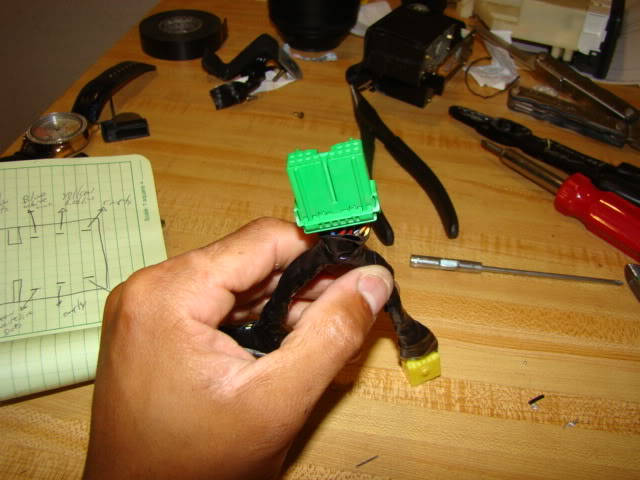

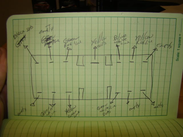

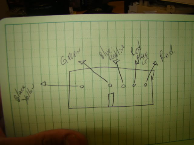

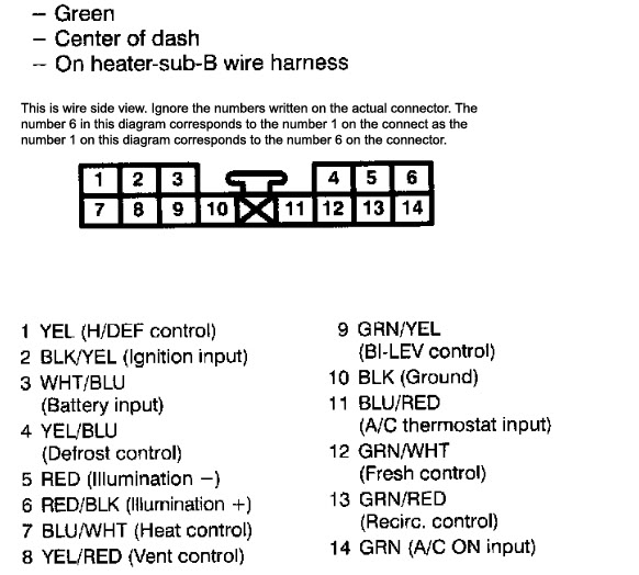

Here is the getto diagram of the wiring. I will make a better one in a few and update this.
At the end, you should come up with something like this...

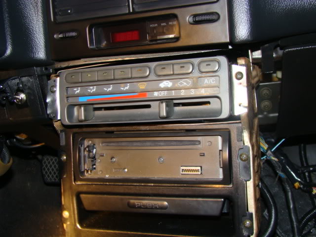

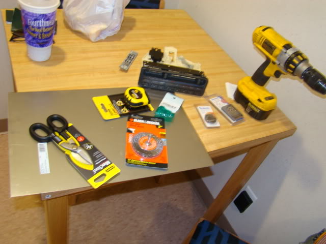

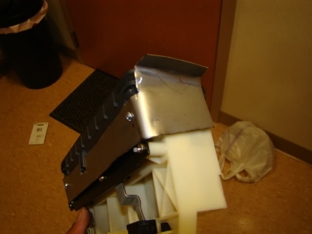

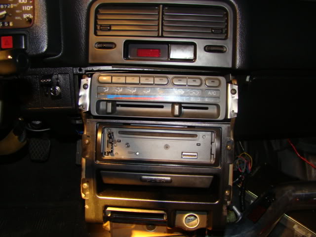

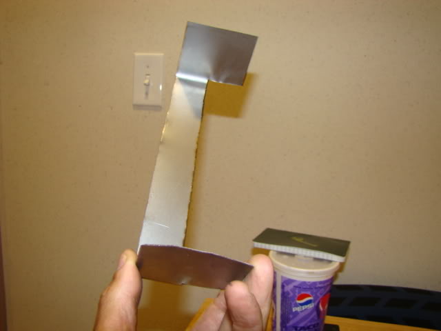

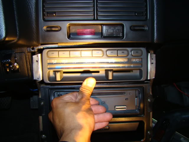

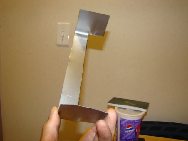

I had the day off today, so I went shoping for some tools and a sheet of aluminum... Here is a pic of what I picked up from LOWE'S....

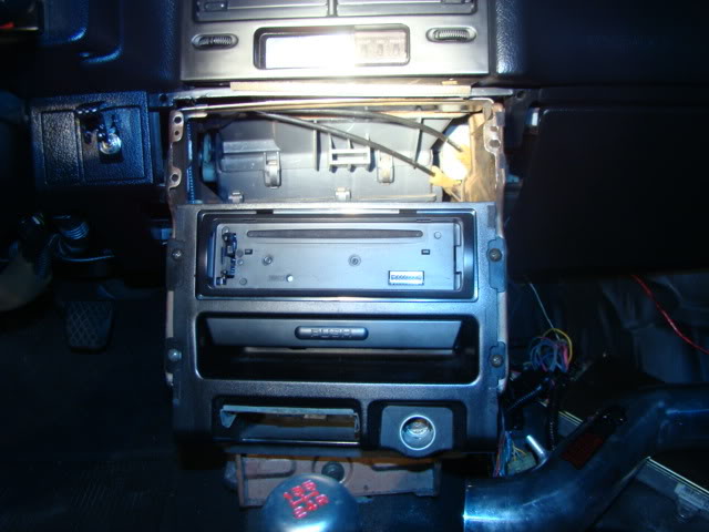

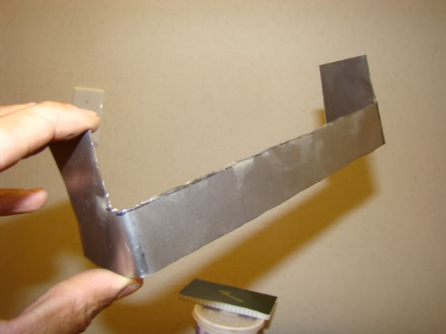

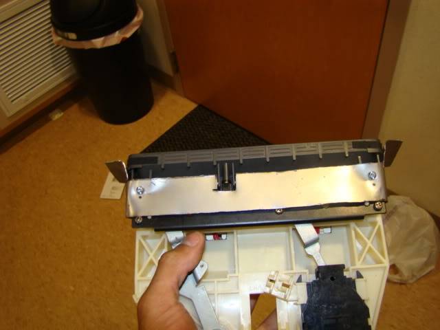

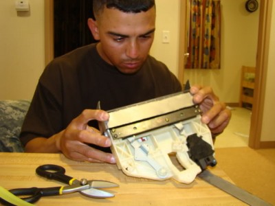

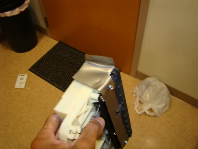

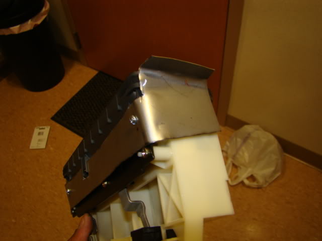

So what I did was some type of bracket to hold the unit on the original place where the REX unit goes to. There was no modification done to the center console.

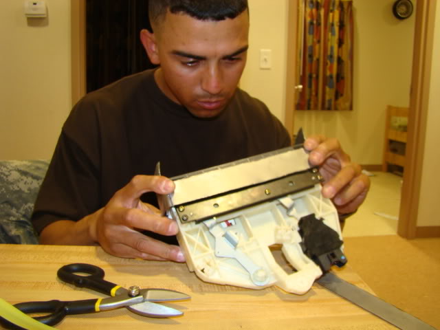

Here is what the bracket looks like...
Mounted on the unit...
Here i am test fitting the unit and the bracket to meassure where I was gonna drill the holes for the bolts to hold it.

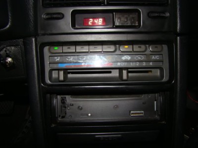

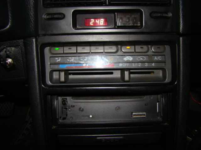

Mounted on the center console

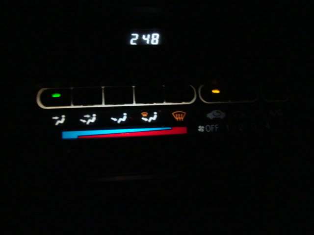

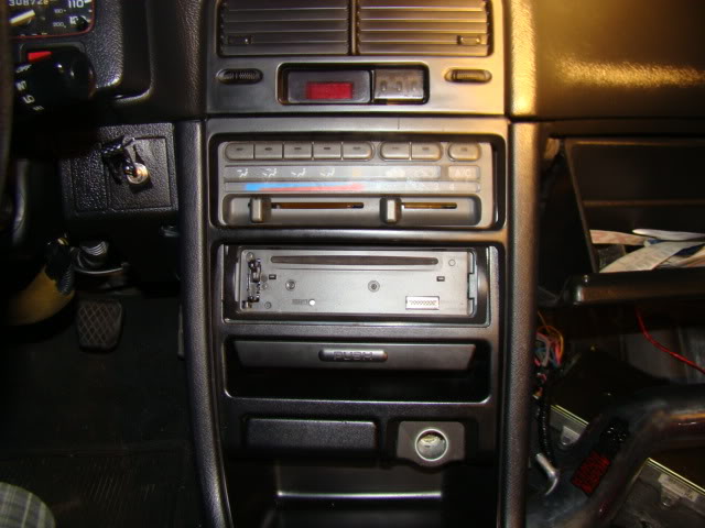

And with the plastic cover of the center console installed. Basicaly done... in the morning im gonna try to tweek the bracket a little bit to macke it fit better, I ran out of day light But here it is...
Looks like I got a burned ligh bulb

Příspěvekod Vojcek » 18 lis 2010 22:06
Návod je dobrej. Akorát teď řeším problém, se správným zapojením drátků. V návodu je totiž uvedeno, že na tom širším zapojení je 2x zelený s bílím pruhem. Což i přiložené rozložení na drátky (sou tam napsaný funkce) vyvrací. Je tam totiž 1 čistě zelený, 1 zelený s bílím pruhem a 1 zelený se žlutým pruhem. Zítra to budu zkoušet ,jak to bude doopravdy. Jinak bude taky docela sranda s bovdenama. Můžete čekat další rady- protože tohle je problém ,kterej sužuje asi každýho kdo má CRX *jizda*

ahoj panove,tak jsem si jednoho krasne zimniho a studeneho dne rekl,ze by bylo hezky udelat neco s mym panelem topeni,kery uz bylo lepeni a stejne to nebylo ono... no a zrodila se myslenka,ze vyuziju ten panel z c5g kterej mam v garazi...trochu sem googlil,ale nevedel moc pod cim hledat,pak sem nasel zde tenhle navod a pouzil jej jako predlohu... nakonec se povedlo a zda se,ze vse funguje jak ma...prihodim poznatky
ve velkem konektoru u CRX jsou opravdu dle obrazku dva zeleno/bile kabely... nekdo psal o tom,ze jeden je zeleno/zlutej... ale ani nikde na anglickych forech sem poradne nevycetl co s tim... takze byla dobra testovani ... zapojil sem jeden zeleno/bilej do konektoru a vyzkousel...zdalo se,ze vse funguje...pak sem zkusil zapojit k nemu i ten druhej zeleno/bilej ... vyzkousel... a vse svitilo a myslim ze i lip prepinalo ... konektory sem nechal v crx puvodni az na malej zelenej,ten sem rozpinoval...na zbytek sem koupil fastony a zasunul do origo konektoru....ten hlavni na ovladani ventilatoru zustava,akorat jsem do nej prepinoval zelenej kablik z elektriky co vede z panelu c5g... fotky dodam snad casem a nebo vubec :) jestee chci panel striknout domatny cerny...
