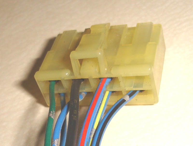

Here is the Accord fan switch plug for visual reference:

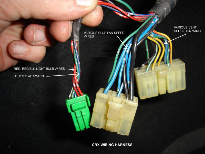

This is the CRX harness for reference:
Being that the Accord controls are more plentiful, and the CRX controls are rare, I opted to clip the plugs off the CRX harness as I figured I'd not ever be going back and re-installing another CRX control.

Wiring the fan switch. Most all of the wires are the same color, the blue/red wire on the accord plug (5th speed) is not used:
During testing I found that my light circuit for the control knobs did not work. I had to clip the wires off the bulb and hard wire them to the CRX harness. The light wires are the red and red/blk wires. You will almost certainly be able to just connect the red, red/blk wires as shown here:
There is some confusion as to wiring the grn/red and grn/wht recirculation/fresh air connections. The grn/red and grn/wht MATCH between the Accord and CRX. Therefore:
Accord grn/red is attached to the grn/red CRX wire.
Accord grn/wht is attached to the grn/wht CRX wire.
I tried both and visually verified that the operation was correct.
One thing of note is that there are TWO grn/wht wires coming out of the CRX harness. One goes to the recirculation switch and the other to the floor/vent control. If you get them criss-crossed like I did, no big whoop, the world does not end. The recirculation vent just goes into a never ending continuous open and close cycle until you press the fresh air button. If this happens, just switch the grn/wht wires as seen in the diagram at the bottom of this page.

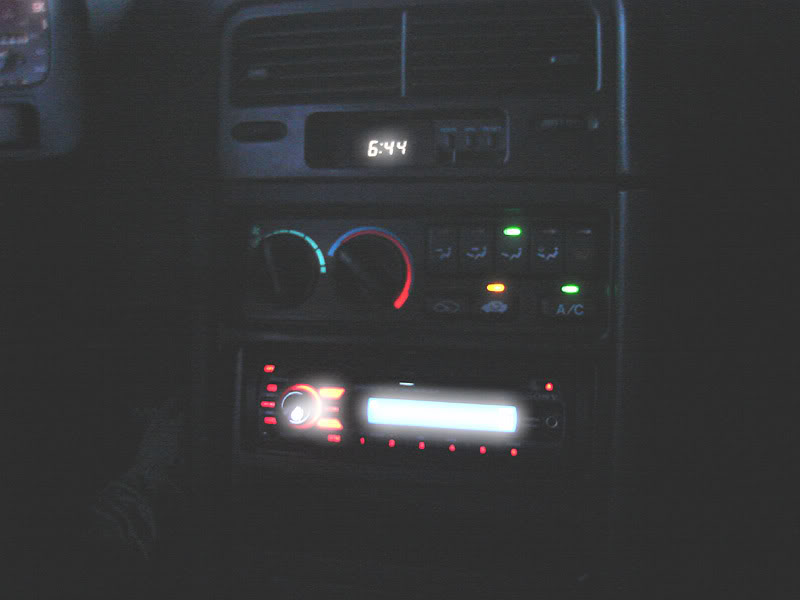

Another view of the assembly:
Another/moar:

Note: blk/yel on CRX goes to yel/blk on Accord plug FYI.
